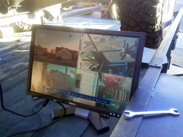

Another really productive day yesterday. Today the rig goes back to Andrew for button up on his end and there is a *chance* we'll be completely ready for Dirt Riot. The big questions marks are the steering box back from PSC, safety nets from Mastercraft, and the drive shafts back from Phoenix Rack and Axle. As far as out end... man you guys are awesome. Jennifer started referring to the jeep as "the rabbit", because every time she came out front, there was another jeep and another great friend out front working on it! Mike pulled 12 hours along with help through the day from Chris and Jimmy. Matt was a big stud and after work came by and stayed until 10:30 and completed all the wiring! Video system is installed for 4 remote cameras (Mike's pic above), plus the race lights, the switch panel, all accessories, brake lines, center console, center panel, all fuilds filled and topped off (including changing the oil in the transfer case and both diffs), and cleaning up all underhood wiring!

Had a good time hanging out with Alan and Mike. The camera system is sweet! and the custom stock dash panel looks killer.
