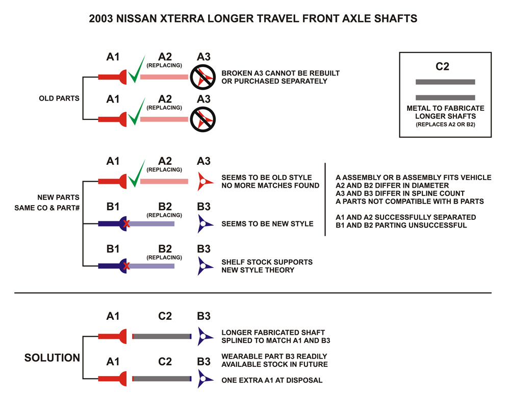

4wd! Custome extended length chromolly shafts in.

So nice to see that. The nice thing is that the cvs are stock replacements. I don't think your breaking an axle.
#96
Do both sides match?
#97
sweathog wrote:Do both sides match?
Yes.
See diagram for the way they are setup
5393
