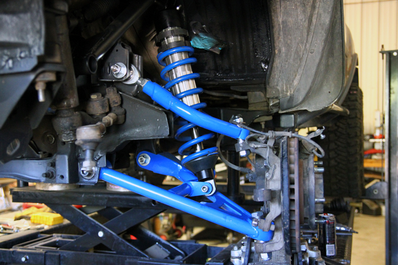

Still waiting on Rock Krawler to send out the 2.5" coilovers :(

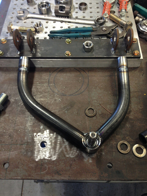

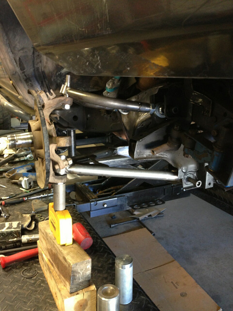

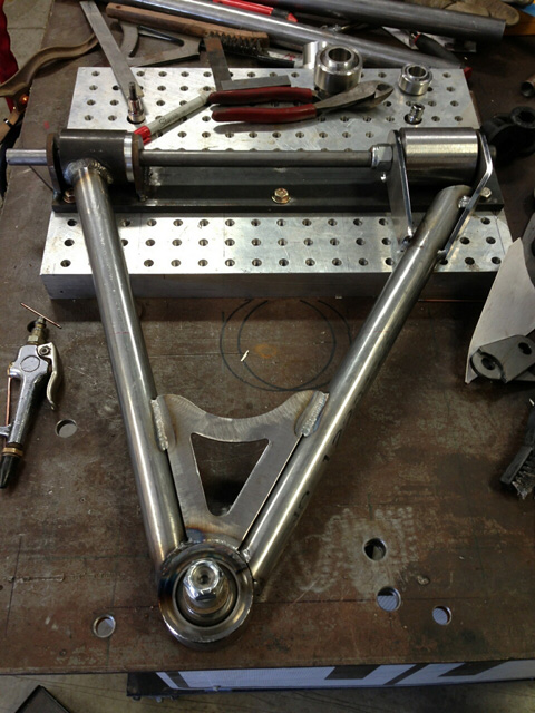

Arms are almost done and ready for them
Pics are before full weld and gussets and cross bar.

I think tie rods are today and the shafts still need some extra metal to reach for 4wd. Just trying to find the right stock for it.

Drove it home tonight. Chris had to cut some 14" coils down to about 12.5 to fit right. They are 500's now because the 450's sank too much. We'll see how this set up works and need to lift the front up an inch.
