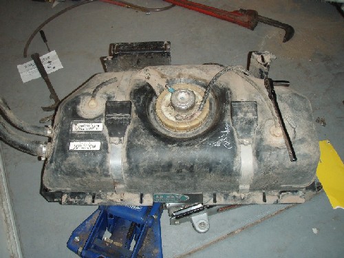

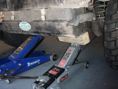

Since I had these, I thought Id throw the pics up.
Replacing the fuel pump is pretty easy, support the tank with a few floor jacks, unbolt tank, disconnect fuel lines and lower it

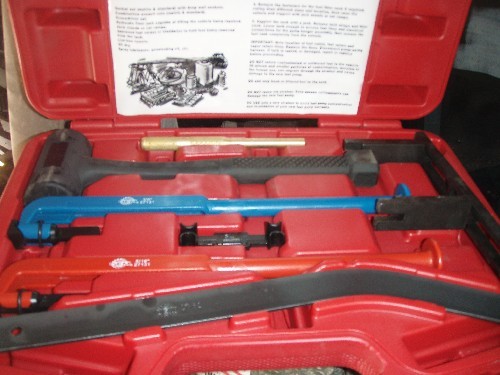

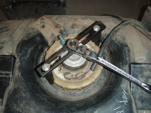

After its out, you need to remove the lock ring that holds the pump into place. You can get it out using a very large strap wrench but I couldnt find one that fits. Its much easier to go to autozone and rent the fuel pump removal tool
After that, just pull out the old pump, and be careful not to spill gas and place new pump back in. Torque down the lock ring to factory specs and reinstall the tank
