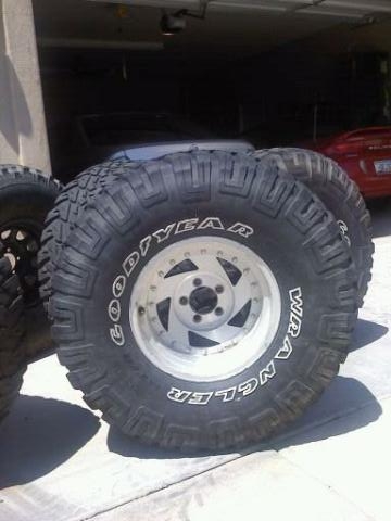

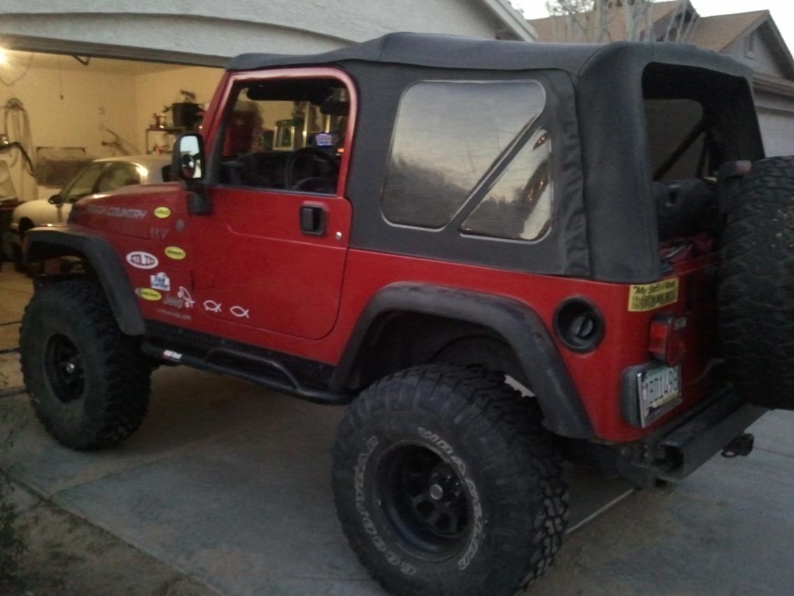

looks like i will have 35s real soon. have to decide on what rims will put up for vote when i get pics of them
Buying these 5 35x12.50 goodyear wranglers on sat8)
going to stay with the black rims and throw the 33's on these rims and get rid of them.

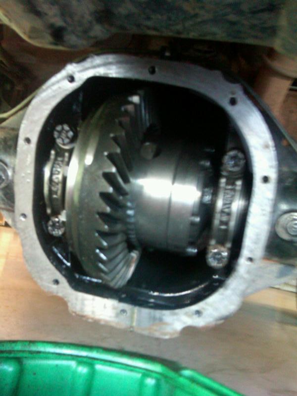

inside the rear diff. just finished changing the fluid.

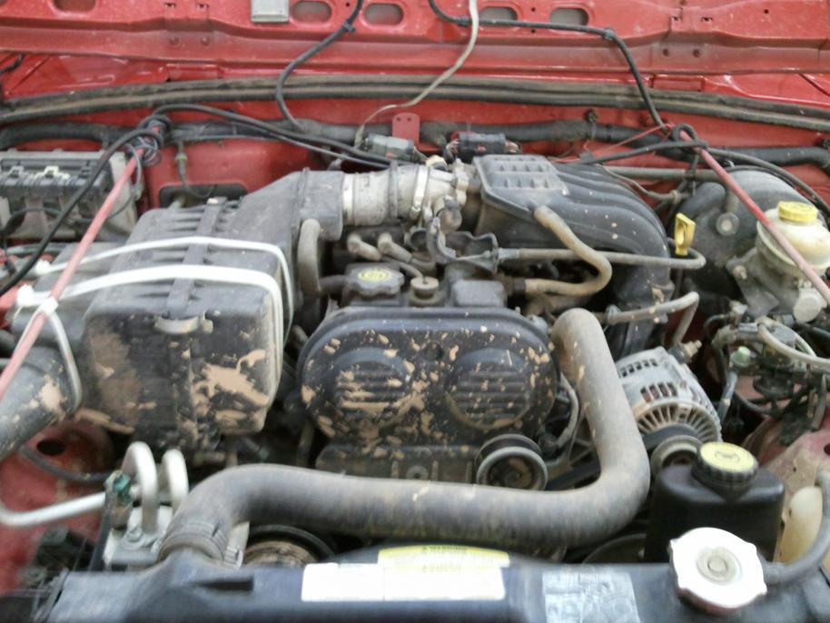

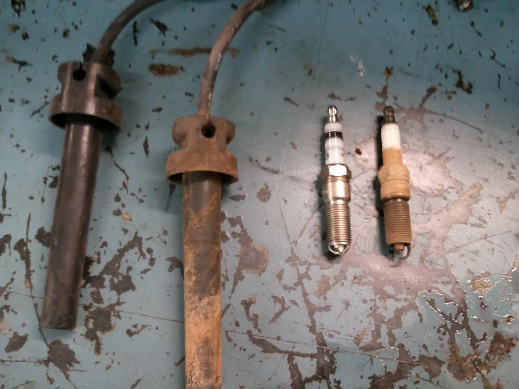

since i will be working in that area it is also time for new plugs and wires.
just got home from doing the wires, plugs and installing a cold air intake on red. what a difference i can feel a little more power and i will test out the milage when i go out sunday to wickenburg.

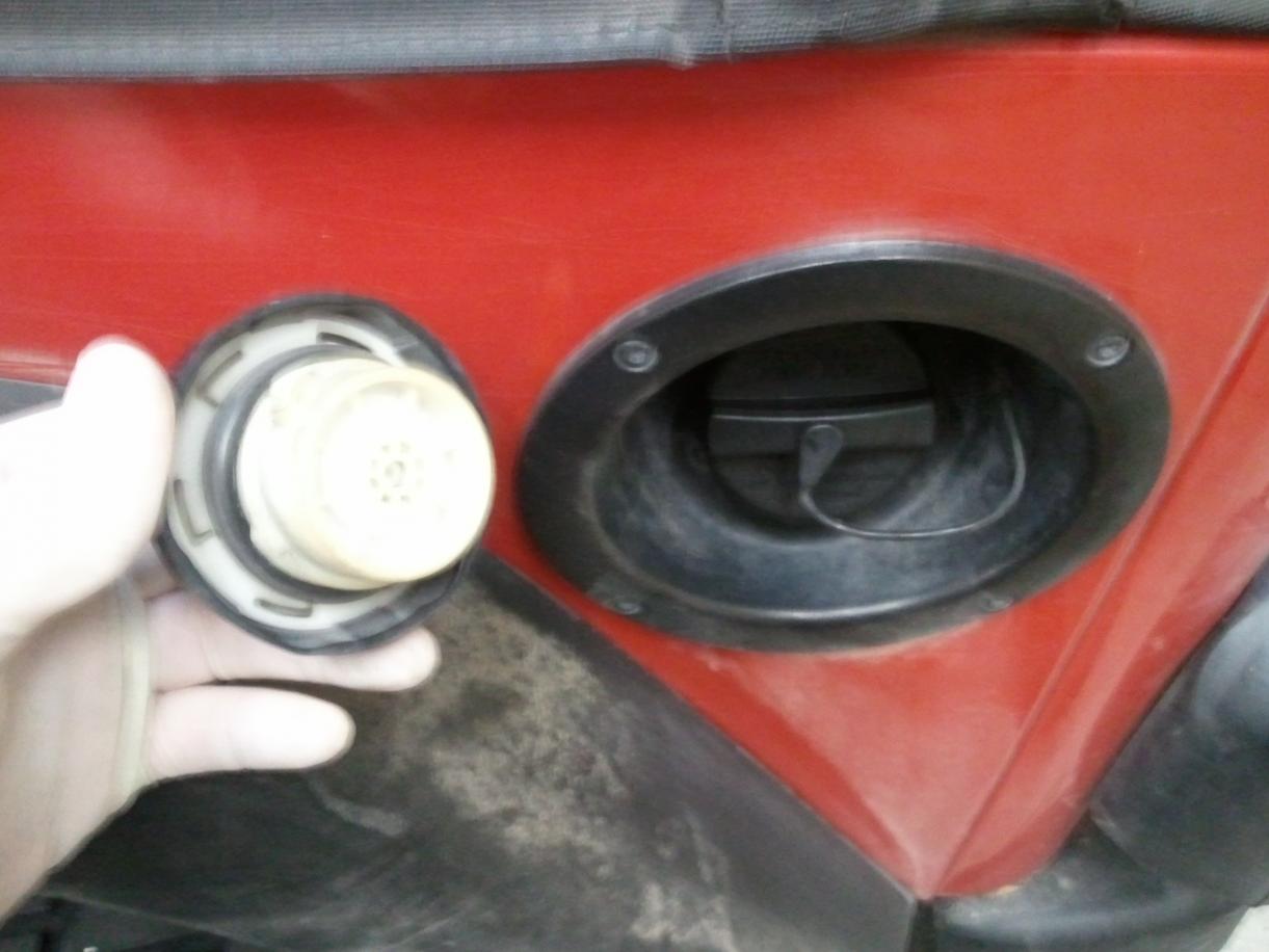

:)had a check engine light saying there is a small leak in the gas cap, replaced and drilled a hole to attach platic strap. forgot to clear the code doh!!! will have to do that later

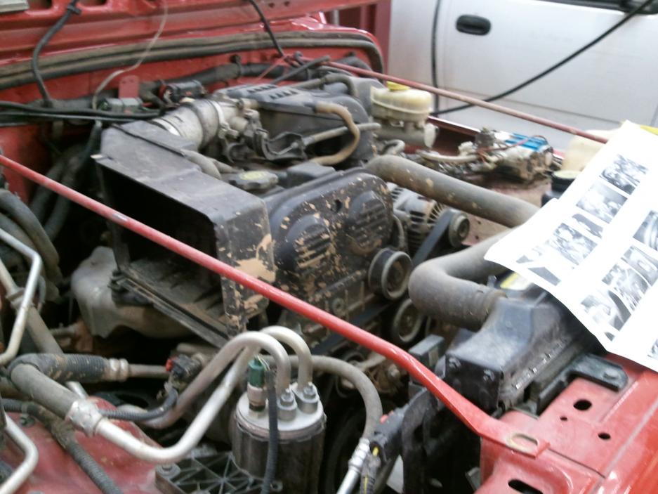

next was to plugs and wires

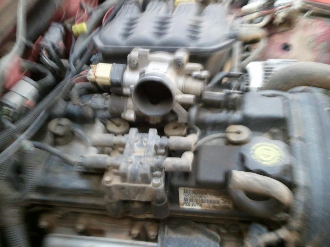

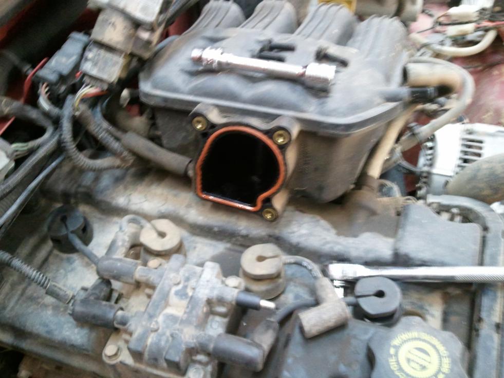

as you can see you have to remove the throttle body to get to the center plugs and since i was installing a cold air intake it was a good idea to do this now
easy ones first
with the body off it was easy to finish the job

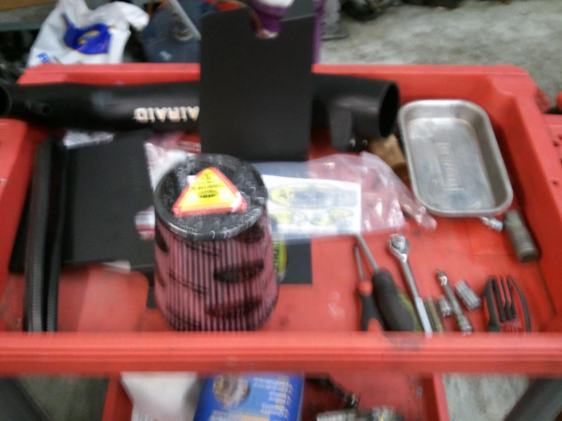

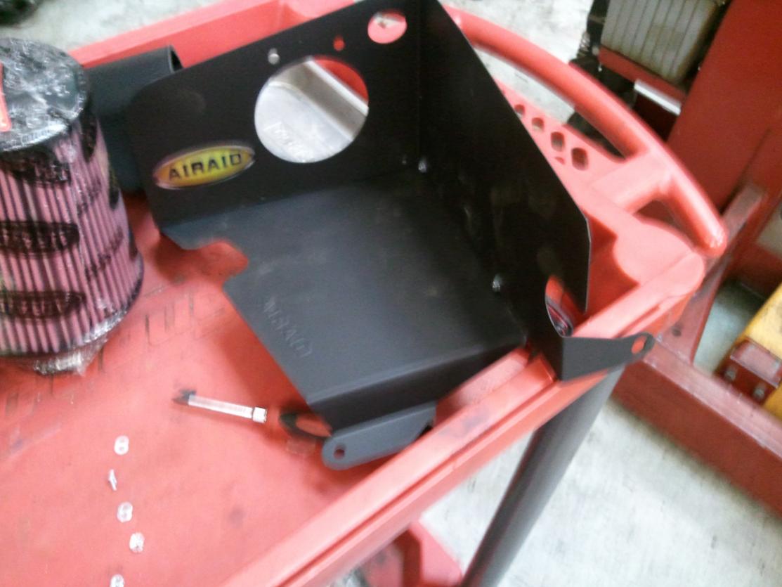

the parts and tools ( i know the pics suck, stupid phone!!)

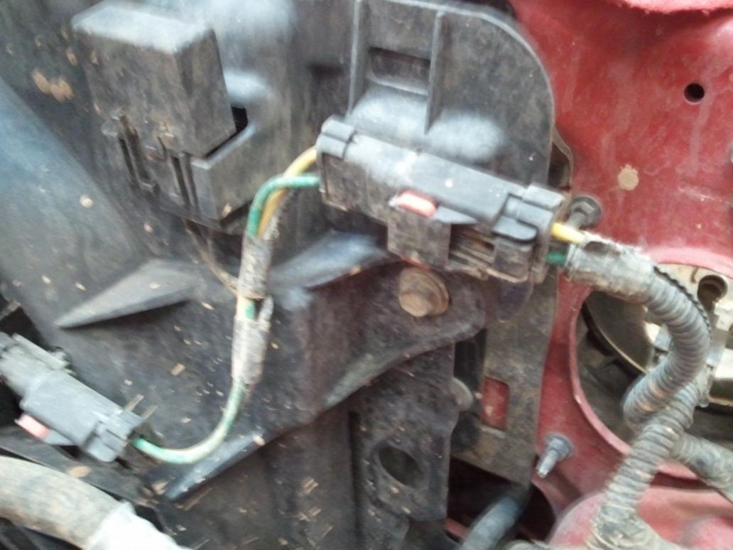

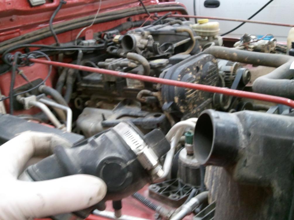

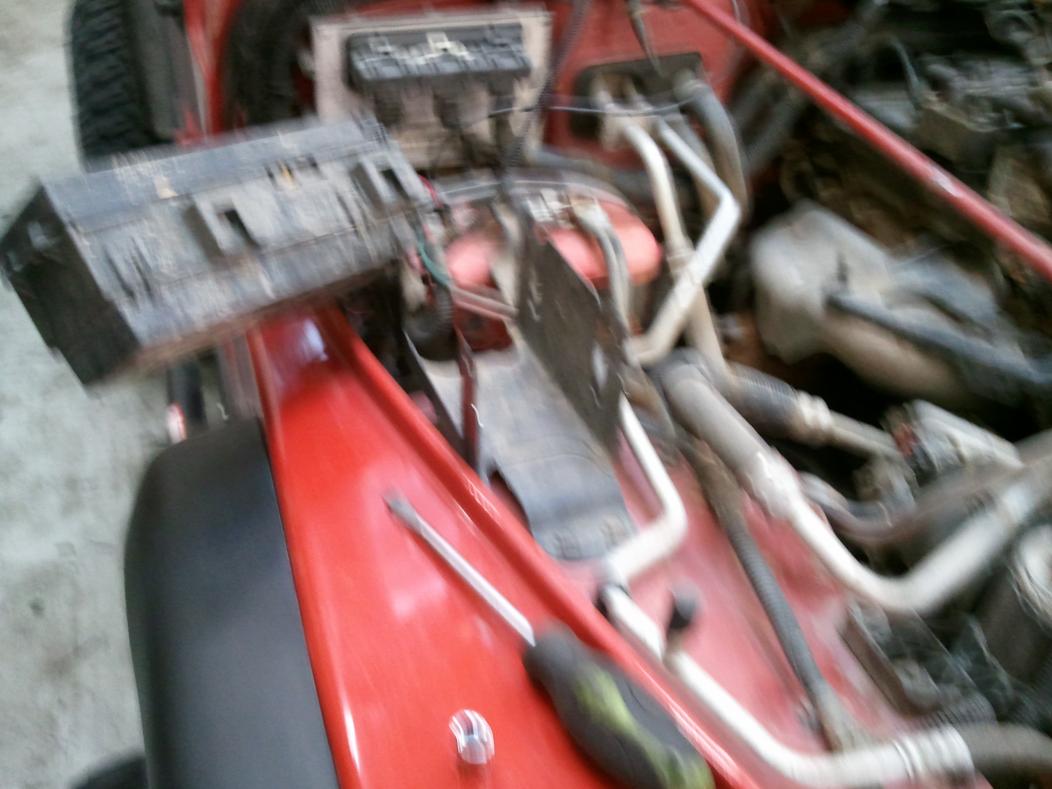

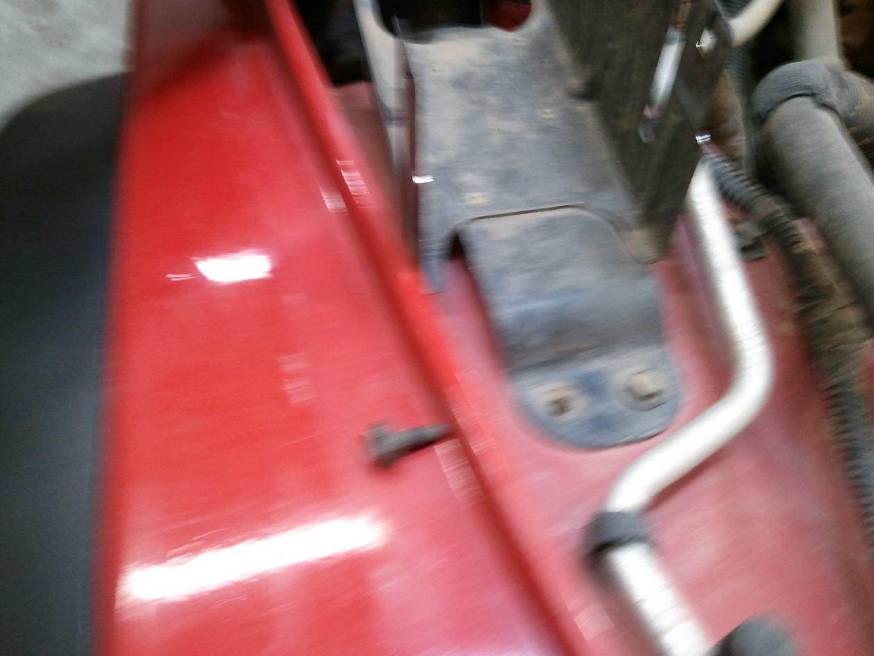

remove the bolt holding the support and remove front of filter save bolt. if you had a broken clip cut your panduit straps off.
then disconnect fthe rest from the throttle body and save the rubber hose for later
remove fuse box from bracket

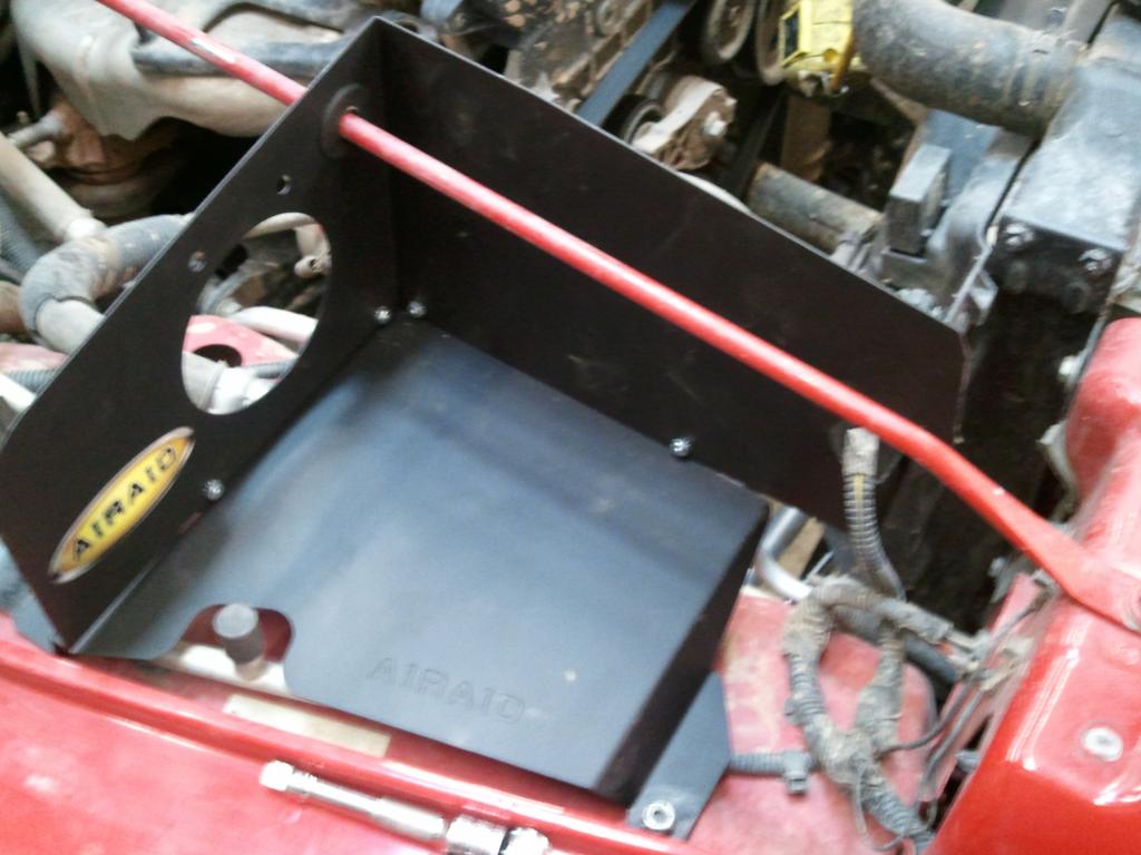

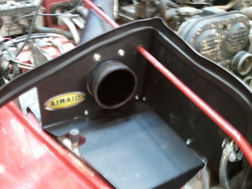

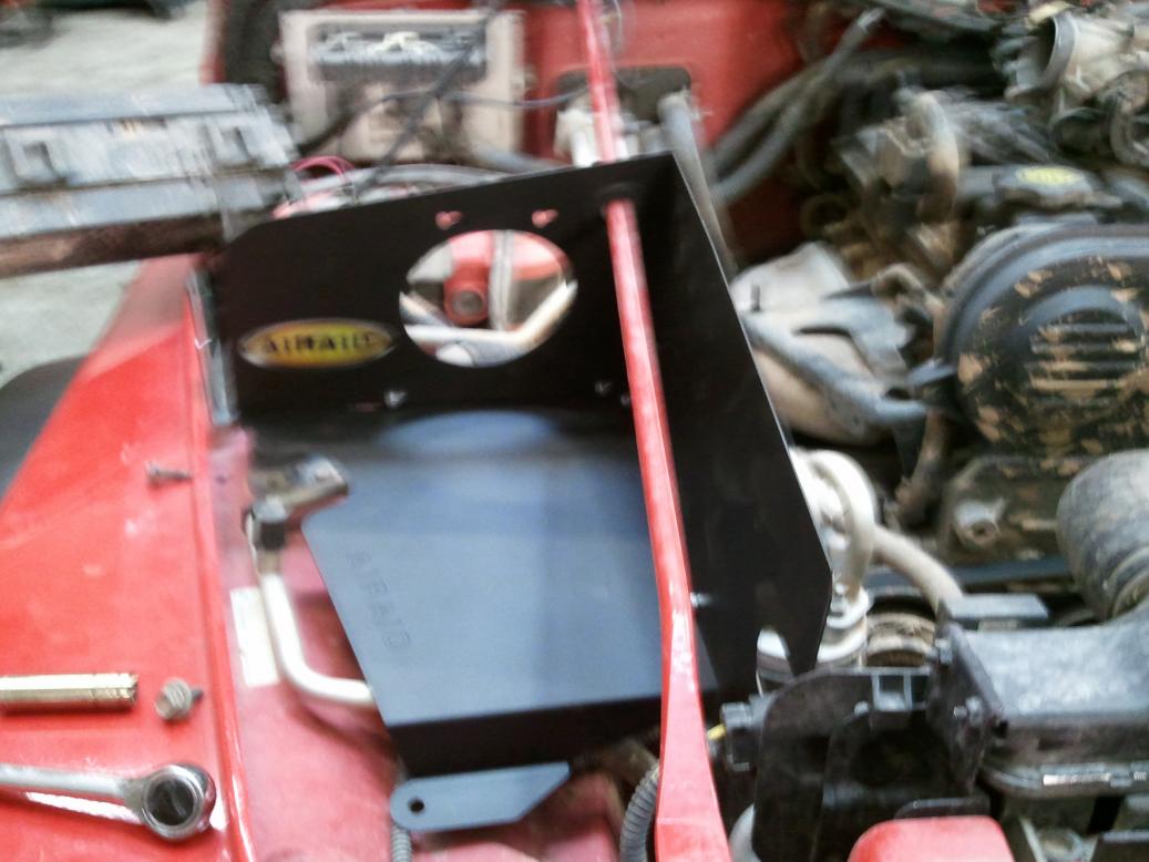

now it is time to put together the box that came with the kit
remove bolt on fuse box bracket
remove bolt on fan mount
slip box through the brace with the gromet that came with the kit
box will ine up with the bolt holes you just removed. i added a nut to the third hole to put it on my light i have in the fender. the kit comes with a bolt and nut to attach to this hole.

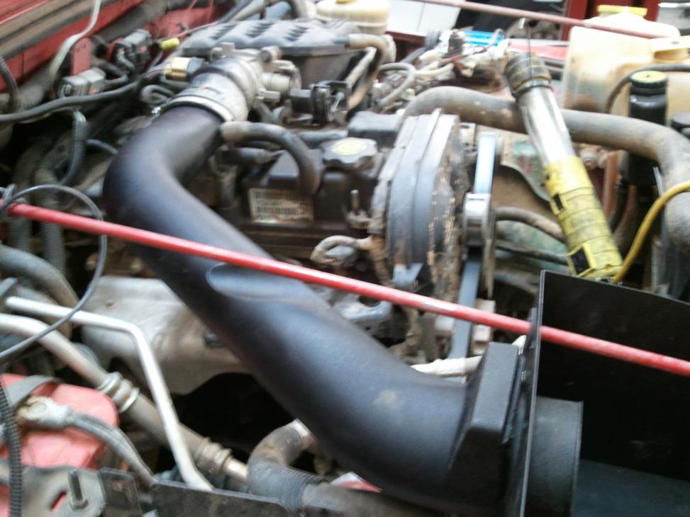

connect the platic tube to the rubber tube and reattach to throttle body
attach to bolts to the box and tube and secure them together.

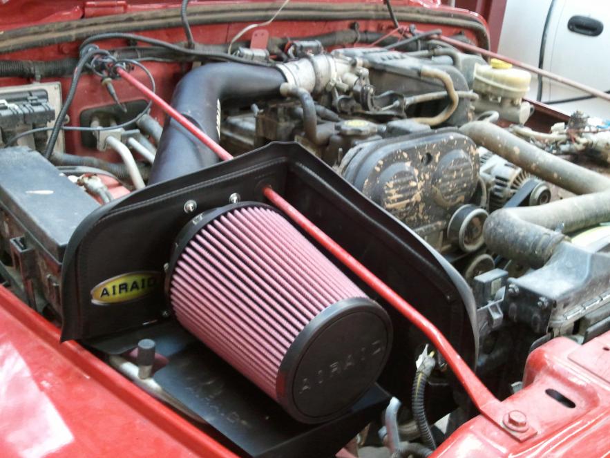

attach cone filter and weather stripping around the box

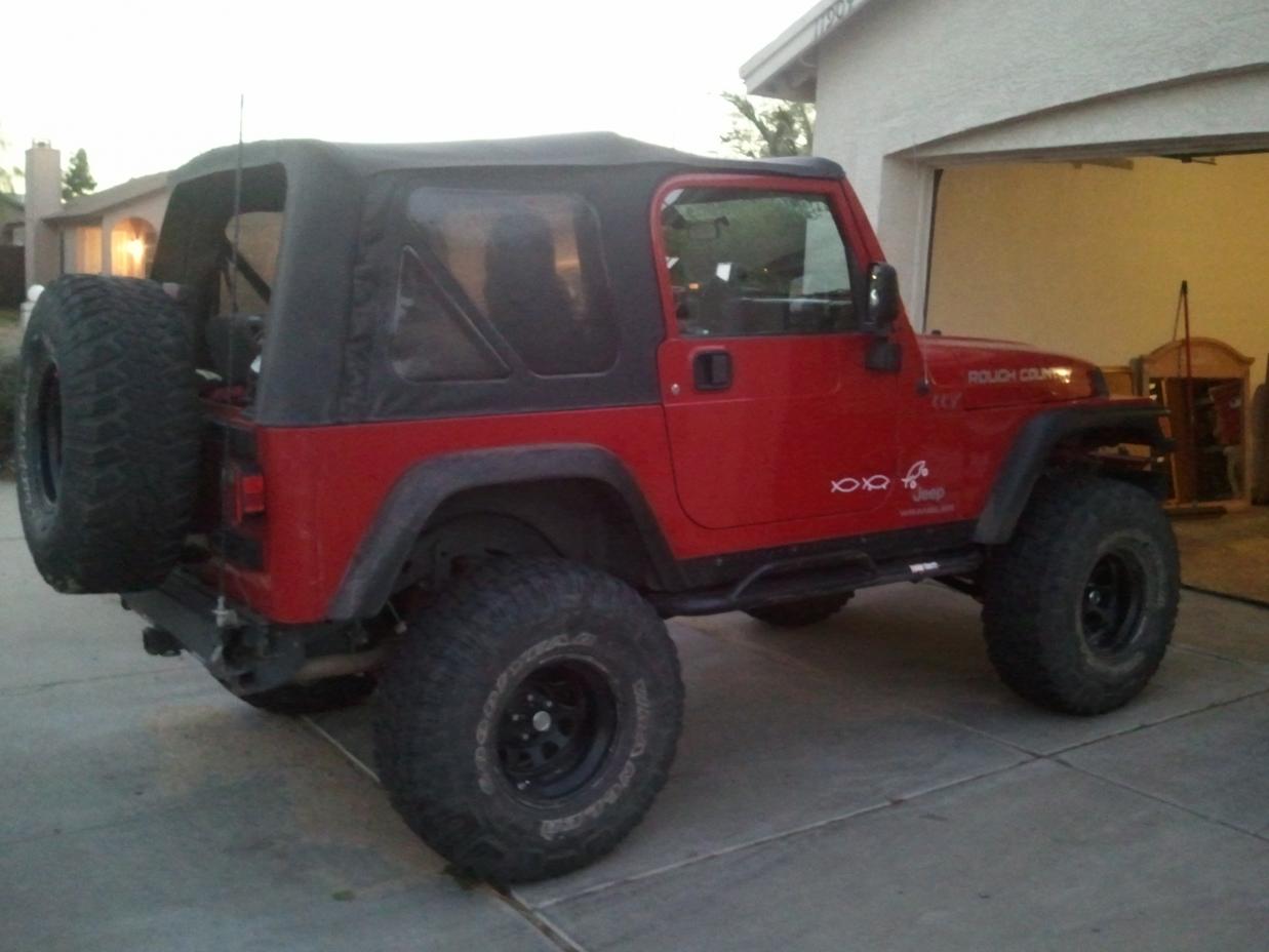

now attach stickers to jeep and take for a test drive.
overall this is about a 30min install add 15-20 mins if you change plugs and wires. fairly easy enough for one person to do this install. instructions are easy to follow.

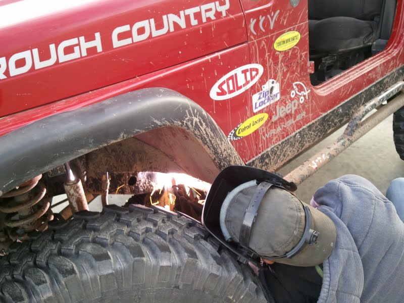

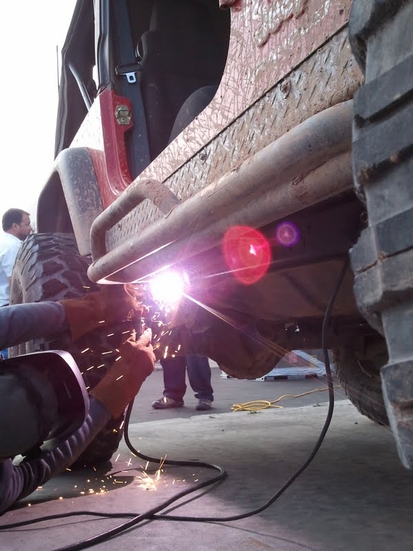

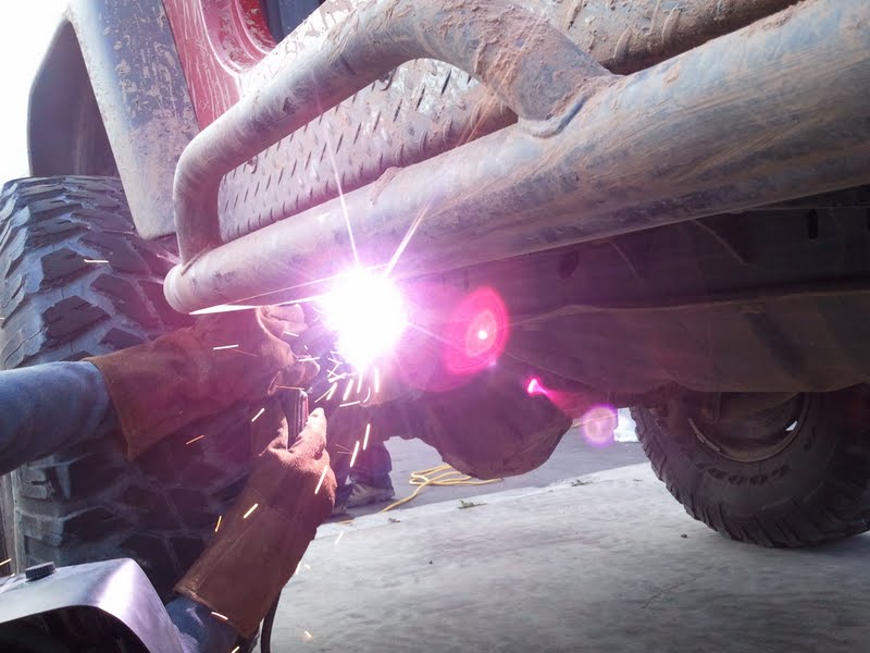

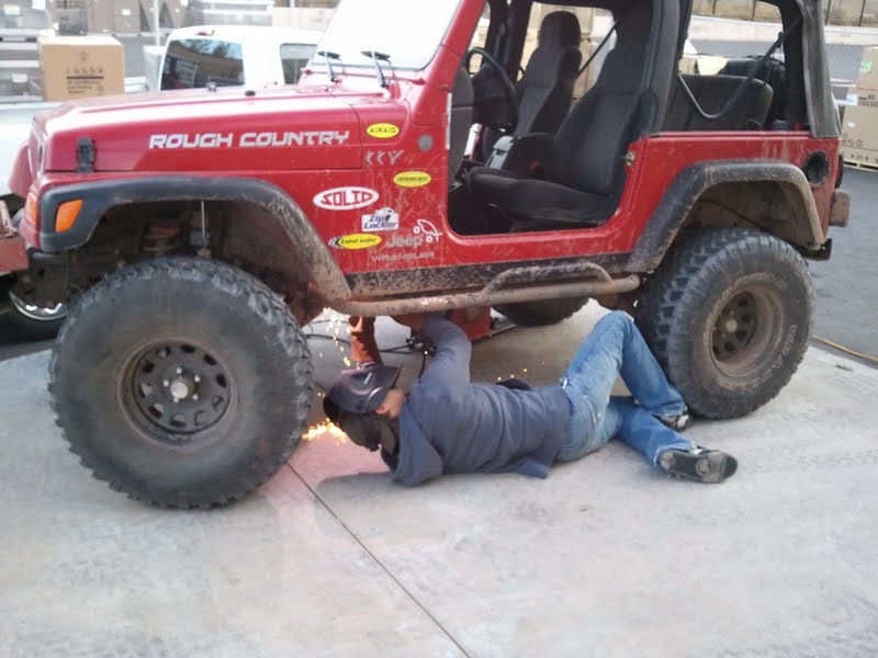

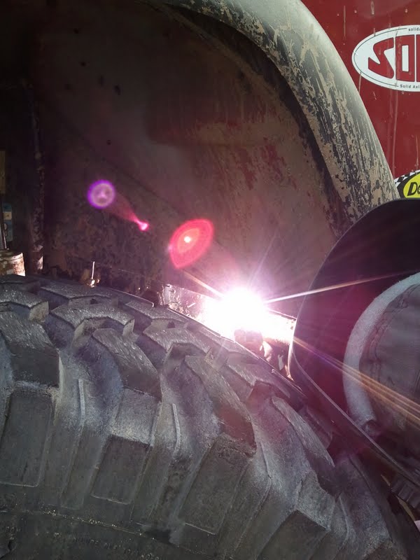

it is finally time to get the sliders welded on. out at butcher jones found a bolt had come out and another was stripping out so i had richard (yetti) weld them in for me. here are a few pics for ya.
