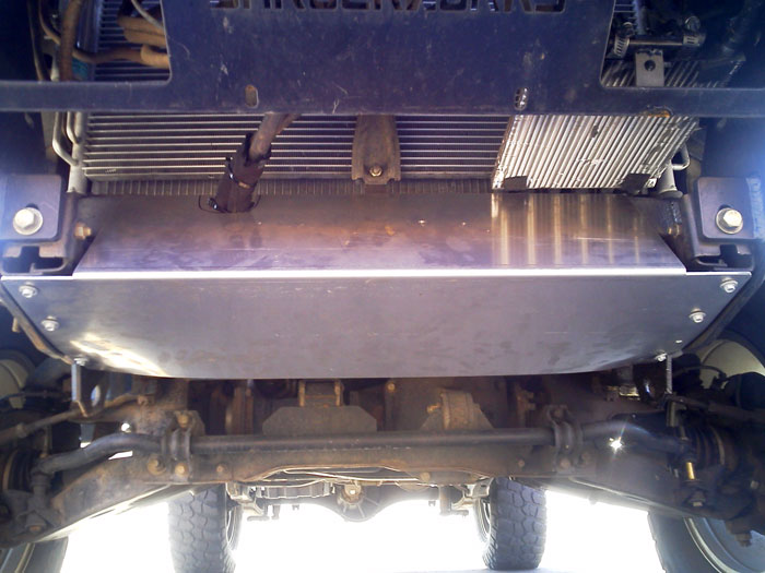

Updated work:
Last night put in a 10degree cooler thermostat
Today: Lost Offroad Chris made me a cool air dam/skid up front
*Special tranny cooler mount on right made by Showboat Geoff.
That looks sweet! Awesome job.
hows the temps? you probly havent had time to try it yet, plus like we were talking today the ambient air temps are a bit lower today.
Yeah, I freeway'd it back to work, but it had been sitting a little while, and I don't think it was 100deg yet out.
The tstat so far is keeping normal drive temps lower on the dial so at least I know there is a difference from the 180 one I had in.
