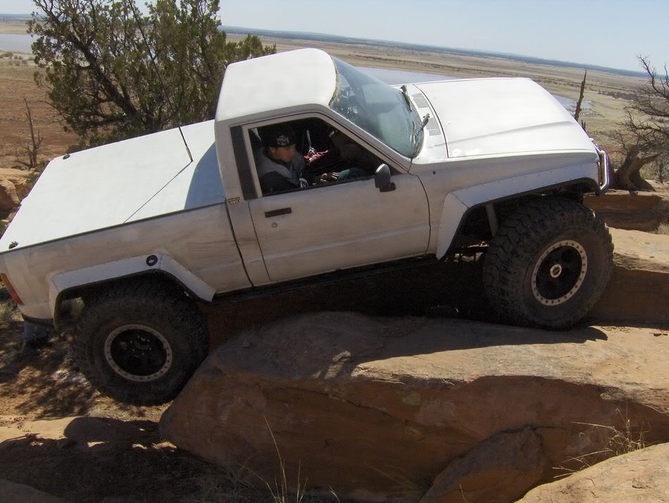

    Tire: ProComp Xterrains
    Size: 37 x 13.50R x 17
    Vehicle: 85 Syota
    Suspension Lift: Uh, Um, Well........
    Body Lift: 2"
    Current tire mileage: Un known, bought used, mostly trail
    Appearance: Agressive and direction I run them in the standard direction.
    Tread life: Probably not as good as an MTR, they are softer than standard street but not near as sticky as BFG KX reds or Claws.
    Road noise: Yep
    Street Performance: Run them at 25, pretty round consdering no balance and on beadlocks, slight vibration at 70, goes away by 80. Does take more power to turn them 75 than my old MTR's
    Offroad Performance: Better than my MTR's. Especially on slick rock.
    Failure on MTR's, Success on these tires
    Rock: Great, run them at 9-10 good bulge and traction for my rigs weight. Sidewalls are holdin up well.
    Rain: worked great and straight at 70.
    Mud: Try to avoid that mess......
    Snow: Kicked but at 5.
    Sand: No real deeps stuff but where I've been they hook up and go good.
    Would you buy this tire again?: Not for full price, however I just scored another set with 85%+trad off pirate for a screamin deal.
    Who would you recommend this tire to? Cooper STT or Procomp Xmud terrain, same compound, no directional tread and better priced.
    Sy
    85 Syota, 6.0/700r4/203/300/60's/Detroits/37 MTRk's/§XX§
    02 Symmins tow beast..... a few goodies
    High Country Renegades
